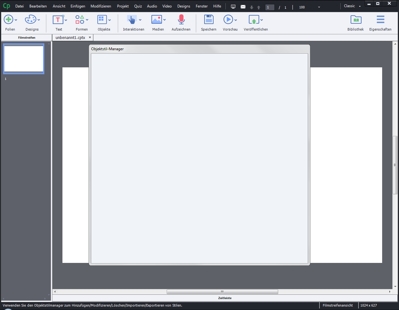

When opening the Object-Style-Manager (via Data) just a blanc Window appears and Captivate crashes.

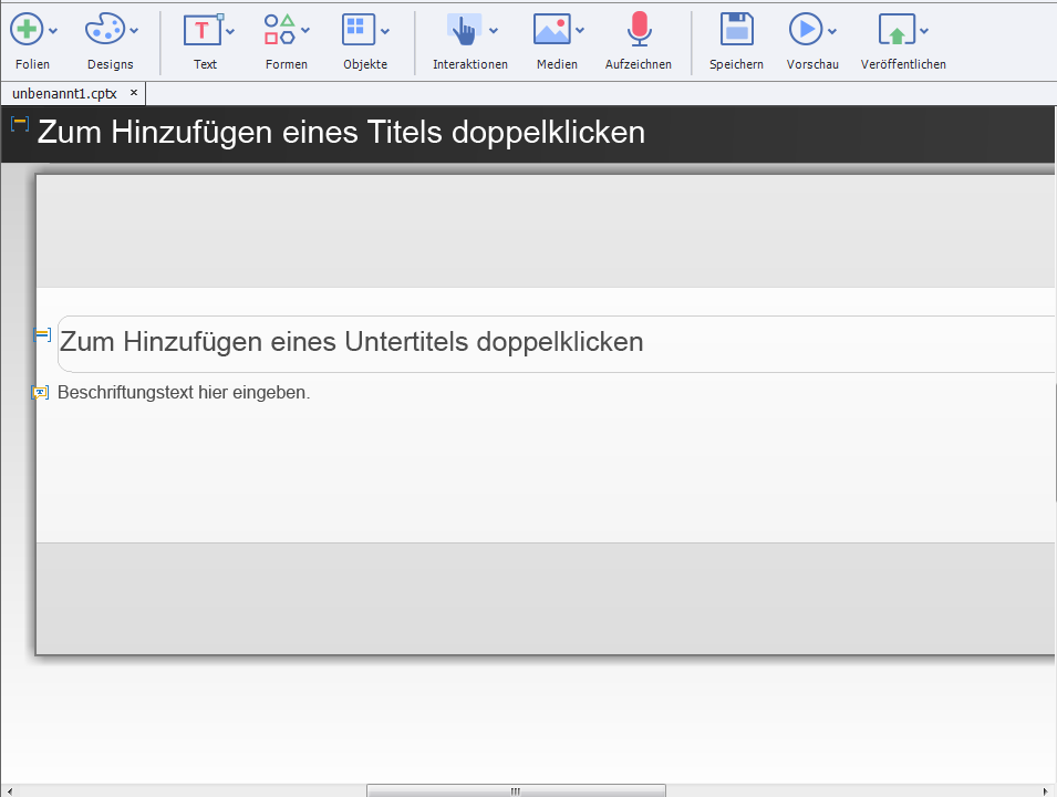

Normally Captivate starts in a blanc project with a slide that contains three boxes for text and other stuff. All my slides are empty. There is no Style available and no Object Style Manager.

New Here ,
Jul 17, 2015 Jul 17, 2015
as you can see Object-Style manager is empty and corrupted. On the last pic you can see in the preferences that there is no style loaded. Its written custom. Normaly it starts with a prepared slide. This one is empty.

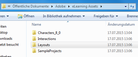

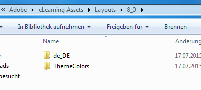

Sorry for waiting, I just reinstalled it, deleted everything, the public Folders too, Creative Cloud and everything.
I created a new local User Account with admin rights, aktivated the Administrator Account, and started with "run as Administrator".
YOUR QUESTION:
I see this:
That looks OK, except for the Theme Colors, I see more theme colors, you have only the Shade Theme Colors. I explored them to write this: Theme Colors - Captivate blog
The themes are normally linked with the Theme Color palettes that don't have 'Shade' in their names. I am using the English version of course. With all my experimentation I can have changed the content of the Theme Colors. The ones without 'Shade' are also in Gallery\Layouts\8_0\ThemeColors  under the installation folder. They are not copied to your Public folder. You could do it manually but I'm not sure it is necessary.
How is it looking this time when you open the Themes (Design in your case) button?
New Here ,
looks like that....
