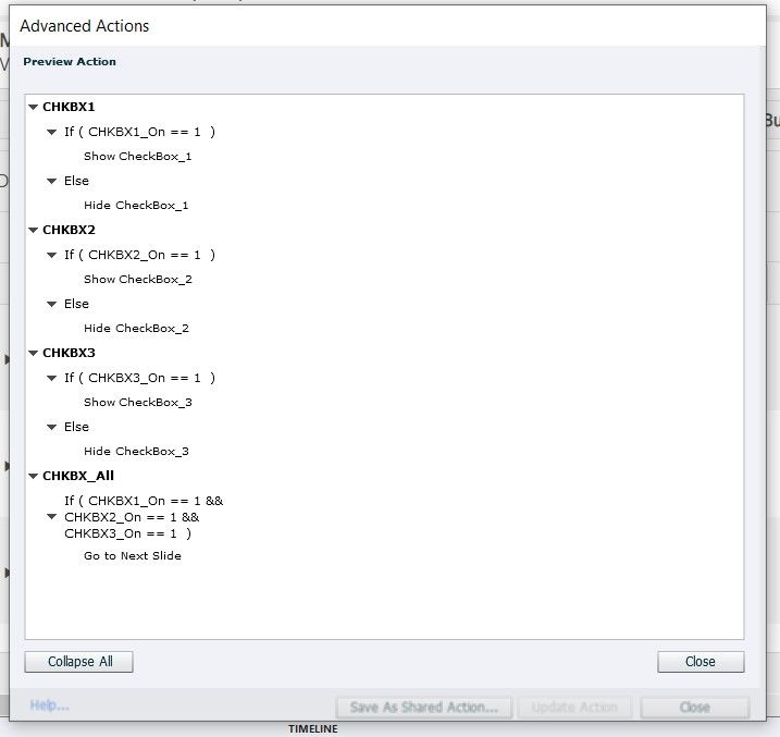

Some information is missing: which EVENTS do trigger which actions. Which version do you use?
Images are fuzzy (it is this forum, ot you). Is it possible to use the Preview feature of Advanced actions to show the complete action in one screenshot? Preview button is the first button in the top right control panel, looks like an arrow.

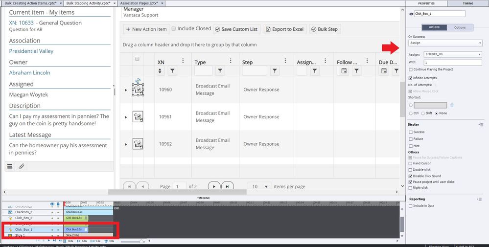

The event that traiggers the action is clicking the Click Box. On Success > Assign: CHKBox1_On
(See screenshot below.)
Here is a screencap of the Advanced Action Preview. Clicking the ClickBox should assign the Variable with 1, but that is not translating to showing the image. Clicking all three also does not advance to the next slide.

Which EVENTS do you use? You show me an advanced action with 4 decisions, but it is important to know which event is triggering that action. I suspect you are not using the correct event to have the wanted result.

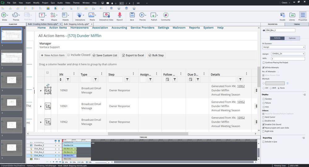

If I'm understanding an EVENT correctly, the Click Box is set to "On Success" > "Assign"
Each of the three click boxes does the same On Success > Assign of the corresponding variable.
Once all variables are assigned with "1" then the final decision is triggered to go to next slide.
The Advanced action itself is set to run on entering the slide.
If you're looking for something else, then I think I'm definitely not understanding what you mean by Events, and I should start there.

That was my suspicion indeed. An action happens only when the event is happening. The On Enter Slide event happesn on the first frame.  At that moment none of the Boolean variables is toggled yet to 1, so will have no effect whatsoever.
You have to use the Siccuess events of the click boxes tto trigger actions which not only assign 1 o the variable but also change the states of the checkbox, and check if all variables have been toggled to show the Next button. This is the logic of ay event-action programming, which you may have misunderstood.

So does that mean I would need to initiate separate Advanced Actions for each click box?
LEGEND ,
Oct 29, 2019 Oct 29, 2019
Indeed, but they will be not so complicated. You will need an action with two decisions:
  1. First decision 'Always' will not be conditional, but assigns the value 1 to the variable of that interactive object and changes the state for that checkbox
  2. Second decision 'CheckAll' is what you now had as last decision. Since sequence is always respected, it will also test on the variable which just got its value 1
Duplicate that action, and you'll only need to edit the first decision: change the variable and the multistate object which is the checkbox. Nto so much work at all, and the action is less complicated.
