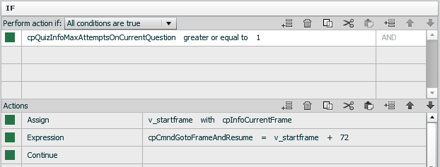

I am trying to get a slide to jump to a certain frame on enter.
On enter, the below below advanced action is triggered. When I try to navigate to this slide (for instance, using a 'go to previous slide' button to revisit the slide) to cause the advanced action below to perform, the whole project just freezes and won't let me move.
Any suggestions as to what I'm doing wrong?
Advanced action (causing the issue)
A little more context
My quiz slides are set up so that on answering a question (correctly or incorrectly) the slide will continue along the timeline revealing the correct answer as well as a short explanation of the answer AND the next button.
The advanced action above is really only for if a user wants to revisit a quiz slide, for whatever reason, so that when they revisit the quiz slides it puts them at the point in the timeline where the next button and short explanation are already on the slide.
I applied the exact advanced action (as above) to a button on the slide, and when I used to button to execute the advanced action it worked perfectly.
I'm also a real captivate newbie, have only picked it up a few months ago. Used lilybiris post: Micro-Navigation in Adobe Captivate - Captivate blog to get to this point, and now I'm stuck.
I'm using Adobe Captivate 6.0.0.199 if that's of help.
I hope this explanation makes sense.

Couple of suggestions.
Using the cpQuizInfoMaxAttemptsOnCurrentQuestion system variable in your condition statement might not give you the results you're expecting because that variable returns the maximum number of attempts allowed for the current question, not the number of attempts the user has made on the quiz question.
Secondly, if your jump to a previous slide is being blocked by something, it could be due to having Backward Movement disabled in the Quiz Settings.  So check that.

Michelle,
As I explained, that particular system variable cpQuizInfoMaxAttemptsOnCurrentQuestion just holds the value of the HIGHEST or MAXIMUM number of attempts that the user will be allowed for a given quiz question.  It's always going to be equal to whatever you have set as the number of attempts allowed for a particular quiz slide.  It sounds to me like you are expecting the variable to show how many attempts the learner still has REMAINING on a given quiz question.  But that's NOT what it will be.
You can prove this to yourself by inserting a text caption on one of the slides BEFORE the quiz, set it to be timed for REST of PROJECT and then insert the cpQuizInfoMaxAttemptsOnCurrentQuestion system variable into this text caption so that you will be able to see it's current value at any point in the quiz.  Change the number of attempts allowed on some of the quiz questions (set to 3, 5, 23 whatever) and then watch this value change as you go through the quiz.  You will see that the value DOES NOT change or count down when you are stuck on a given quiz question and putting in wrong answers repeatedly.  It always shows just the maximum number of attempts set for that quiz question.
So using this system variable in your condition makes no sense for what you are trying to achieve.  It's ALWAYS going to evaluate to TRUE since all quiz questions will allow at least ONE attempt.
I think the issue you are experiencing is possibly related to the fact that you are trying to jump to a given frame AFTER the start of the quiz question slide.  Captivate may simply need to enter the quiz slide via the first frame.  Quiz slides are a bit of a special case in more ways than one.
I suggest you forget about jumping to specific frames and just execute what actions you need to happen on the slide via the On Slide Enter event.

You are referrinng to my blog post, but I see that you use an older version of 6. Can you see if an update is available (for 6) under the Help menu?
The quizzing system variable which you are using is reused on each slide. I never tested to see its value when a question slide is revisited. Rod's idea about testing that var, is the first thing I would have suggested as well. Personally I would have used a user variable for this purpose, but that means one user variable for each question slide. It could be a Boolean var, default value = 0, but toggled to 1 when the slide is visited the first time. Same if you want to count the attempts taken by the user on question level, which has no available system variable (contrary to the attempts on quiz level which are counted in cpQuizInfoAttempts). If you want to track the attempts on question level you'll need a user variable as well. The descriptive list with system variables for CP can be found in: System variables in Captivate 6 - Captivate blog
Return to Quiz command is meant to be used for remediation, not what you want in this case.
