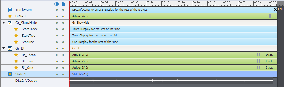

I created quickly an example file, just having a slide with three shape buttons that act as toggles, and a next button. The first three buttons pause at exactly the same time, and the Next button later.
Since it is slide audio, clicking the buttons will not pause the audio at all (common misunderstanding). I created a shared action, with the object to be shown and the variable (mine are labeled v_one instead of v_visib) as parameters:
StarOne is what you want to show/hide. You can click infinite times on each button to show/hide that item. It will not bother the audio, once it started playing it will continue. When audio is over, you can still continue to click. Only a click on the Next button will advance to the next slide. This is my Timeline
No need to rewind the playhead in this case at all.
