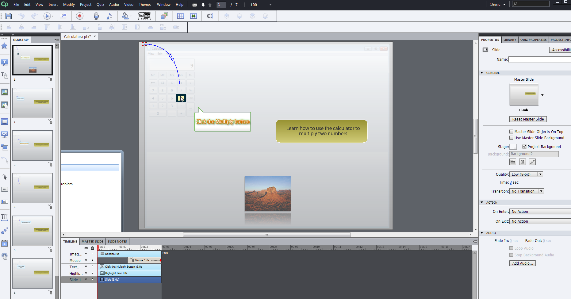

Is it that a software simulation does not allow this? If it was just an image then it would come front and the frame would go back. So howcome the text caption and image then have come in front and but not the calculator? Screenshot attached.

Timeline attached: timeline.PNG

The calculator is part of the background, am I correct if I see that the 'highlight box' is covering everything on the slide?
Your text caption has a separate timeline, and is sitting on top of the highlight box, that is why it is visible.
You need to take a snapshot of the calculator and insert it also on top of the highlight box. Why do you do this using a simulation capture? I would create it in Captivate itself and it would be a lot more interactive. You can use variables and advanced actions to make that calculator really interactive.

It is Captivate 6. Yes the "highlight box" is covering everything on the slide. I'm not aware of the variables and advanced actions yet but that is probably the only solution here. Am still learning the basics. Was learning about "putting a frame" so I tried this in the simulation after I recorded it. I guess it's not possible to put the frame in background. I'm trying but it's just not going to the background of the calculator.

Understand, but try to learn the terminology as well The word 'frame' is a video term, each Captivate movie is published with a speed of 30 Frames per second. A frame is not a separate object at all, I don't understand what you mean with your question? The background of a software simulation is captured during the recording, and the blank master is used for it. You could use that background, duplicate it (possible in the Library) and edit the copy in a graphical application (I am using Photoshop): crop so that you keep only the calculator. You can use that image then to put it (as an image) on top of the background.
