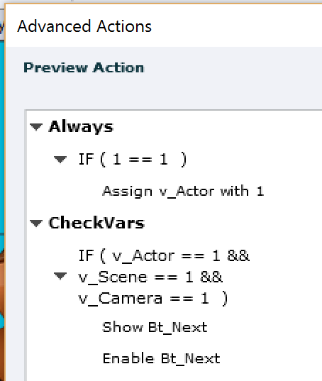

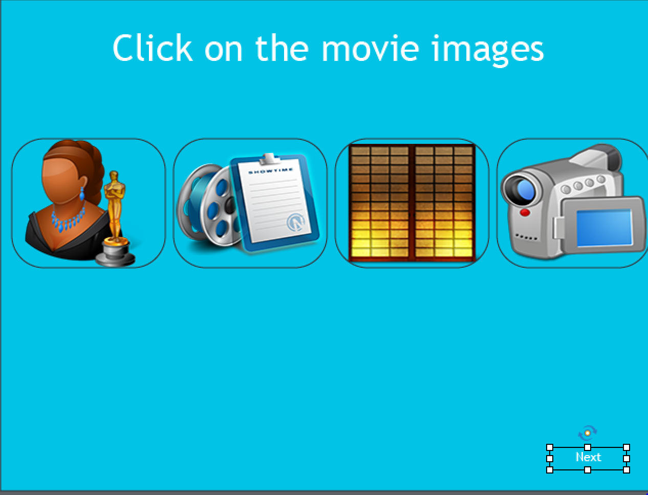

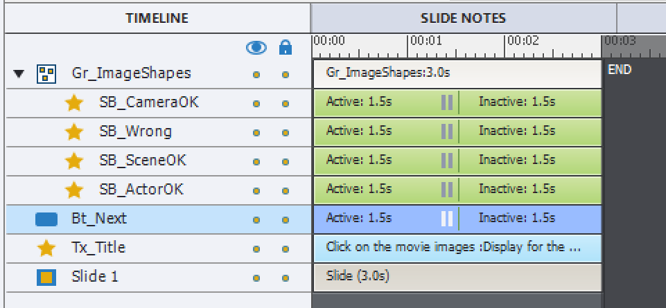

I quickly mimicked your situation in a small project, will try to explain what I did and add more screenshots. Due to heavy renovation works in my house, am working on a Surface Pro (not all my tools are installed here) and with low bandwidth. Sorry for the quality of the images.
I created 4 shape buttons, each one filled with an image. I kept the default pause at 1,5 secs, attempts are left to Infinite which means that only the Success action is necessary because the Last Attempt action will never occur. On that same slide I added a Next button (is a simple button like yours) that is hidden in Output. That button also has its pause at 1,5 secs. Here is a screenshot of the slide and Timeline:
I created 3 user variables that will track the correct images, with a default value of 0
The third shape button with the 'Japanese wall' image is the wrong one. For this shape button the success action is set to 'No Action'.
For the other three shape buttons I used the conditional actions which you already created, and here is a screenshot of one of those actions (for the other two you need to change the variable in the Always decision):
This last screenshot used the Preview window, which you access with the first button in the Control panel of the Advanced Actions dialog box, the button that looks like a Play button. Translation of the symbols (JavaScript symbols):
  ==           means 'is equal to'
  &&           means AND
