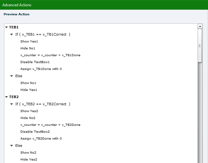

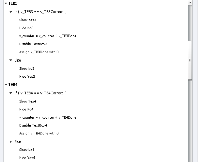

That was a very quick response. Here are screenshots for my advanced actions, variables, and the properties menu.

You'll see that you have a Preview button, first button in the top right control panel. Can you use that button to show me at least two decisions in the conditional action? I need to see how you did set up the second decision, because from your explanatino I think something is not well edited after the first decision.
Your screenshots are confusing: I see both a conditional decision and a not-conditional decions for TEB1.
Why I prefer multistate objects over showing and hiding? It will avoid to have to hide, because onlyu one state can be visible. If you put both checkmarks as states of one multistate object, you only need one Change State command instead of having to Hide and Show. You can use the same name for the states, although the multistate object will have a different name. It makes editing a lot easier, less chance to have bugs.

I have included screenshots of the advanced actions in my project and I have also tried to attach a version of my project so that you can see it in action for yourself. That should allow you to see the stage setup and anything else you wish to view.
What I'm trying to do is have an activity for my trainees where they fill in the nine text entry boxes with an amount of money. Then I would like for my trainees to click a single submit button, which will then trigger Captivate to review all of the text entry boxes and mark them as either correct or incorrect. My end goal is to accomplish what you had in your 2011 blog post, but with 9 boxes instead of 3.

I didn't have time today, but some quick questions. Did you enter the correct value fot he correct variables when defining thme?
Somehting I have to check is the micronavigatin (last command in Else), because in CP2017, especially for HTML output there are some issues which never occurred in previous versions. It is meant to get back in the active part of the TEB's. All TEB's have their pausing point at the same location?
