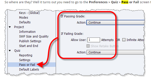

I'll steal a graphic from Rod Ward's Infosemantics blog to give you some context...
I have two advanced actions that are supposed to be triggered when the user enters the results slide -- one on passing grade , and one on failing grade. For some reason it seems the event is not triggering.   The advanced action should show shapes on the result slide and hide others.  It should also log to the browser console and its not doing that..
Any reason why the advanced actions would not be called?
Thanks!
I use Captivate 9.
535
Community Expert , Jan 06, 2017 Jan 06, 2017
Misunderstanding? The actions you point at in the screenshot are triggered when clicking the Continue buitton on the score slide. I explained that functionality in:
Question Question Slides in Captivate - Captivate blog
If you want to have something happening On Entering the score slide, you need to use a conditional action triggered by the On Enter event. You can use the system variable cpQuizInfoPassFail (it is a Boolean) to create that action.
