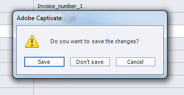

I have created some advanced actions in captivate but I get some weird error messages. It is just some very basic advanced actions where I assign a variable with true and hide/show some objects. I inserted some pictures below so you can see what I mean.
This is the advanced action I am trying to create.
When I try to save the action I first get the usual message that the script is saved successfully. When I then try to close the advanced action window I get this error message.
This seems weird since it already told me it was saved, but I tried clicking on the "save" button. I then get this error message.
Which makes sense since I saved it before. So when I just close the window without saving the changes and go into the action I just created again it gives me a blank sheet. like the picture below.
The advanced action works when I preview the project but I can not duplicate it or see the advanced action.  I have worked a lot with advanced actions but never had this problem before. I tried to create a new blank project to see if the same happened and it did. I also had some other weird things happening to the project I am working on today. There were some objects from other slides that suddenly appeared on another slide. The workaround I found for that was to preview the project with HTML5 in browser.
Do anyone know how to fix this?

NEVER use a cptl-file, please! Especially not with advanced actions. Both Rod and me have tried to tell that everuwhere, because since a couple of versions there are serious problems with advanced actions in cptl-files.

It looks like corruption, either of the project, or in Captivate Preferences. Can you clear the Preferences? Which version do you use?
BTW: for a Boolean variable I never use True/False but 1/0, works perfectly.
Never reuse a name, not even for a decision.

I already tried to clear the preferences. I don't think it can be the project that is corrupted as I tried to open a new blank project and got the same error there. I am currently using Captivate 2017 (64-bit).
I don't know why I use true/false. I just learnt it that way I guess. I tried to create a new project again and tested using 1/0 insted but still get the same error.

Are you on Windows? In that case, do you Run Captivate as Administrator?
The only issues similar to your problem occurred for me when I had reused a label that was identifying an object for a decision in a conditional action.
Did you have a former version of Captivate installed before this version?

Is this in a CPTX or a CPTL file?

It's a CPTL file.
If you want a template for design reasons: use a theme, it has everything on board for consistent design. Look at this article:
What's in a Theme - a Template? - Captivate blog
If you need actions, create shared actions, or even copy advanced actions to other projects. There can be a problem with actions triggered by slide events, but those triggered by other events will copy fine.
Or use a cptx file as a standard, which you open and sae under another name.

I am using windows 7. I did have an older version of Captivate before installing Captivate 2017. I have created at least 10 projects since getting the new captivate version and 2 of the projects were very similar to this project I am working on now. Running the project as administrator did unfortunately not work for me.
I tried changing the name of the objects on my slide so they are not the same as my variables and that seemed to work. Still does not explain why I contently get items and texts from other slides appearing on the current slide but at least they don't show up when I preview in browser.

If objects from earlier slides are showing up on later slides it may be due to having their timing duration set to Rest of Project.  Just select the first instance of that object on any slide and check the Timing panel.
