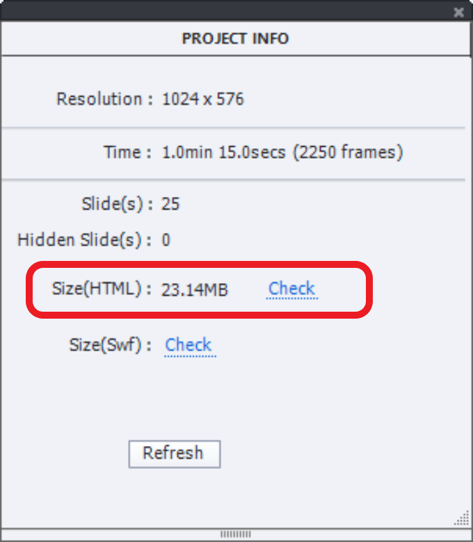

How big is the file size of the output? You can check it in the Project Info Panel which you open from the Window menu by clicking the Check button next to HTML :
I suspect the problem is linked with the file size, if you embedded the videos as event video? I would try to stream them as slide video. You could use YT or Vimeo if you don't have access to a streaming service. Of course learner will have to wait on each slide with a video to upload but it could solve your problem.
