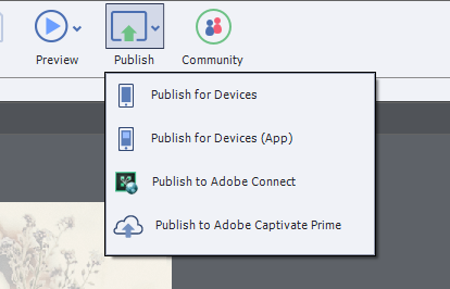

I created the project as a Software Simulation in Demo mode. Then, following the instructions from the only help I could find, I went to File, Save As Responsive to save the project as such. Unfortunately, this has made it so I do not have the option to publish to the computer as a Video. I can only publish to a Device.
I recorded another Software Simulation in Demo mode at the same time, but had not done the "Save As Responsive" yet and it still gives me the option to publish to the computer as a video.
(See attached images)
(Save as responsive.PNGResponsive Publish Options.PNGSimulation Demo Publish Options.PNG

It makes no sense for your goal to convert to a responsive project. I'm sorry that you didn't save the original software simulations.  That is the only way to publish to a mp4.
Remember: I would never use a software sim in demo mode, because Video Demo has a very good editor and the quality of the published output, which is always MP4 is a lot better than with a software sim.
