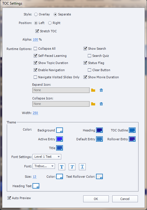

Hello, I have a set of projects where I need to publish to SWF video and have the viewers be able to navigate at any time between any topic listed in the table of contents. Some of them work just fine, some don't. I have checked the two places (TOC Settings and Publishing Settings) to see if there are any differences for the ones that do and do not work and I can't find any. Am I missing some setting somewhere?TOC Settings 1.PNG Publish Settings 1.PNG
Any help and suggestions would be greatly appreciated.

Try overlay instead of separate and see if it makes a difference.
When you say publish to swf video, what do you mean?

Hello TLC MediaDesign:
I think the overlay, while a good idea might annoy the users as they will have to turn it on and off to get it out of the way of the content on the screen. As for publishing, to swf, mean that when i publish the video to my computer, i have the output as as swf which is the easiest format to upload to our SharePoint site. Did that make any sense?

So you have video in your slides? Did you chose the option to extend the slide length for the video or does the video extend across multiple slides?
I wanted you to try the overlay just as a test to see if it solved the issue.
Aug 22, 2016 Aug 22, 2016
Navigation will be restricted if you use Branch Aware (Quiz settings) or Pretest questions. Do you have any of those?

No branching. It's really just a simple "video" with chapters so people can move around to the topic they want to get to quickly without having to see the entire process.
Aug 30, 2016 Aug 30, 2016
No quiz neither? Because setup of the quiz (not Pretest) can be the culprit as well.

I have done some more testing and it seems you cannot move around topics if you have subtopics beneath the main "TOC" items. Once left all of the "chapters" at level 1 in the TOC, i was able to output and then move around between the topics. This works fine for my videos for this project; however, if i absolutely had to have sub chapters, I would still be in in a jam. Not sure if anyone else has experienced this issue. I do appreciate all of your suggestions.
