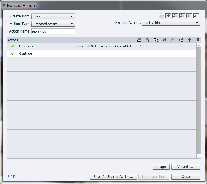

I've tried the posted solutions without success. I also tried the more complicated solution where you set a variable on Enter and set the expression based on the variable. Both solutions cause my basic animation to fail, meaning the audio plays but the animation does not. If I click pause and play a couple times, the animation will start playing. The replay/rewind function works just fine. Without animations, the course is not going to pass muster.  I'm on a PC using 9.0.2.4. Can anyone help? @Lilybiri can you help?

Are talking about the solutions proposed in this blog post?
Replay (slide) Button - Captivate blog
You probably needs the second scenario described there.

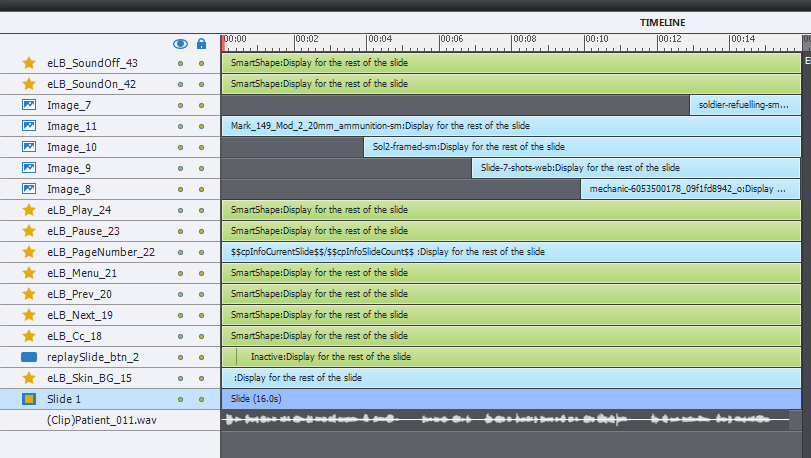

If it is not working, please give some information about what you mean by 'basic animation'? Maybe post screenshots of the timeline, because I need more information

Yes. That is the other solution I tried. Here are some screen shots.
The below image is the timeline. Nothing fancy. I just dumped some images on screen so I could test this without doing damage to my real project.

And, here's where it gets stuck. It never shows the animations past this first image.
All I want is to restart the slide in case the learner missed something or wants to review the content.
Jan 13, 2017 Jan 13, 2017
The Replay button has a pausing point at 1,5secs. Please make it later, all objects first have to appear before that button should pause. That means that the pausing point should after 10secs

Such a basic answer! Thank you! I feel foolish for missing that.
