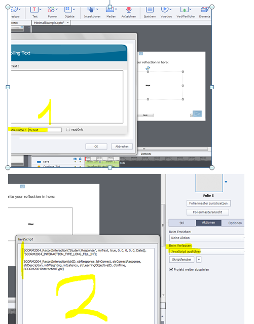

Unfortunately I'm not that familiar with JavaScript. What I did was
Enter the Variable
myText into the widget (see step 1 in the attached picture
entered following script on exit of the slide (step 2 in the attached picture)
SCORM2004_RecordInteraction("Student Response", myText, true, 0, 0, 0, 0, 0, Date(), "SCORM2004_INTERACTION_TYPE_LONG_FILL_IN");
SCORM2004_RecordInteraction(strID, strResponse, blnCorrect, strCorrectResponse, strDescription, intWeighting, intLatency, strLearningObjectiveID, dtmTime, SCORM2004InteractionType)
Is some syntax wrong?...sorry I'm really just a beginner and have little idea of JS.
Thanks for your help
Jul 19, 2017 Jul 19, 2017
I cannot help you with JS, would just have tested the LMS to see if user variables are reported (some do have that functionality).
However I want to remind you that a user variable is not created automatically because you enter it in the variable field of a learning interaction (widget). You have to create that variable with Project, Variables as well. One of the tips in these posts:
Tips - Learning Interactions - Captivate blog
Using Captivate Widgets? Some tips - Captivate blog

People's Champ ,
Jul 20, 2017 Jul 20, 2017
You only need:
You also need to create the myText variable under Project/Variables. If you just assign it in the Interaction, it won't do anything until the variable is created.
