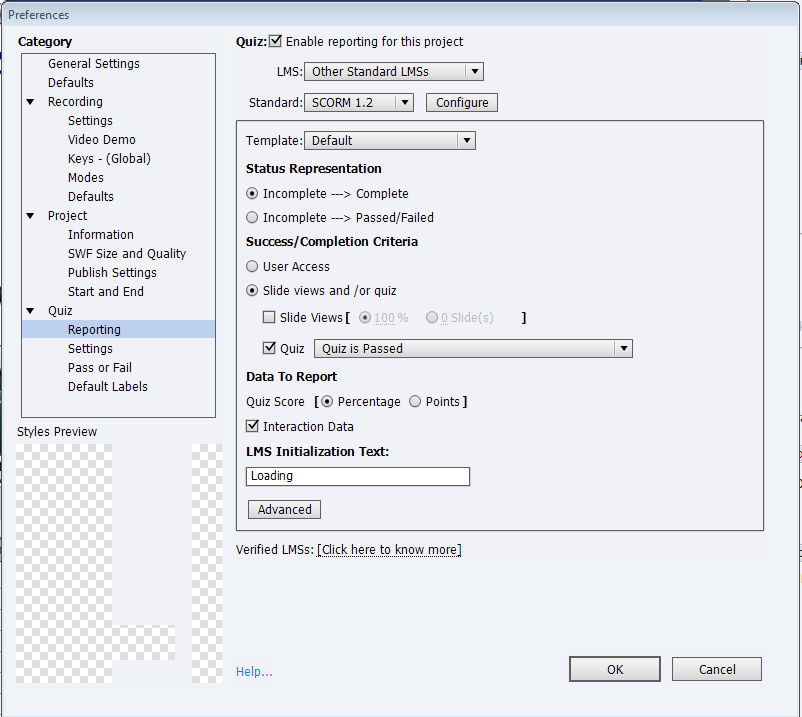

I'm having a problem with a course that is only reporting the minimum score necessary to pass the quiz to the LMS.  Example:  A 25 question test (4 pts each) with a 70% or more total points to pass.  Once the learner answers 18 questions correctly (i.e. scores 72%) no additional scoring information is being passed to my LMS (Meridian).  For the course I'm working on, the threshold is 80% and as soon as you answer 8 of 10 questions correctly it isn't reporting any more information; I've confirmed this by looking at the raw user data.
Here are some screen shots of my quiz settings:
I've gone through and matched all the setting with a course that is reporting correctly, so at this point I'm at a loss.
Any help would be greatly appreciated.

I'm late on doing this, but I wanted to report that we figure out the answer.  Under <File>  <Project Info...>  <Quiz> <Reporting> <Advanced>  I'd checked the box for "Send Data On Every Slide".  What this was doing was sending a "Commit" message to the LMS after each question was answered; causing the LMS be begin a running tally of the score.  Once the score reached the minimum required, but LMS (I don't remember the exact command of verbiage) recognized that the minimum score had been achieved and reject any additional scoring information that came in.  Once we removed the check for "Send Data On Every Slide", the course didn't send the "Commit" until it go to the "Results" slide; thereby showing the entire score.
