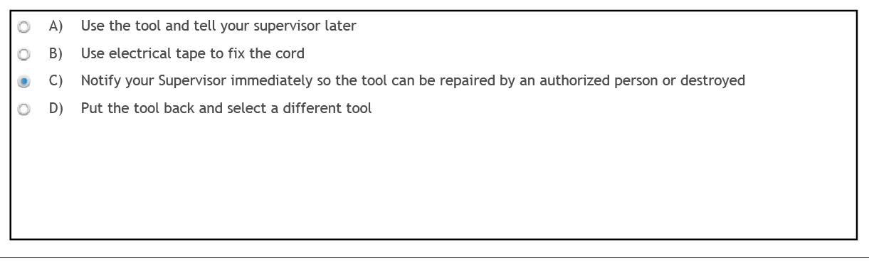

OK Trying my first responsive project from scratch. All went well until the quiz. I can not get the answer boxes to work. If I fit them for a mobile device they get all screwed up when I go to desktop view and vice versa. What am I doing wrong. The boxes for the answers extend past the edge of the screen. They do not reformat to stay visible.

I may have answered my own question.
I set the Quiz properties to shuffle answers. If the answers are not all in the same size text box the spacing gets all screwed up when shuffled. Some of the answers are very short and others are much longer. So I am changing the setting so that the answers are not shuffled.
Not the best fix but it works. It seems the answer text is shuffled but the text boxes are not. So if you set up the first answer and it is very long and the rest are short. Make all the text boxes fit the answer text, when the shuffle happens the long answer gets shoved into a small text box and does not fit.
