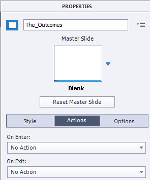

I am using Captivate 2017 (10.0.0.192) and am trying to apply a slide transitions (for the entire slide, not content or objects on the slide).
This webpage provides simple instructions to do this, however I cannot see the transition list.
I have a slide selected from the filmstrip and these are my options.
Appreciate any advice.
Jayne.

Slide transitions are a SWF (shockwave flash) animation. As such, they are not available for responsive design projects due to being exclusively HTML5 format. I suggest looking into HTML5 animations and using object effect animations to try and mimic what you want your slides to do. Be sure to go to Project -> HTML5 tracker to see if there is any SWF conflict.
LEGEND ,
Jun 30, 2017 Jun 30, 2017
You are working on a responsive project, which doesn't support slide transitions.  Was that tutorial for a normal project?

Yes you can. You have to select your slide then press on "Timing" (next to properties top right) then select from the drop down options. There doesn't seem to be any control of the length of the transition eg I wanted my fade to be 5 seconds but I can't seem to control that anywhere.
Moderator: you cannot use slide transitions in any responsive project or in a non-responsive project published to HTML. Check the HTML Tracker
The info in this answer is irrelevant, only valid for SWF output.

Sorry, you give wrong information Slide transitions are NOT supported for HTML output. Responsive projects are always HTML.
