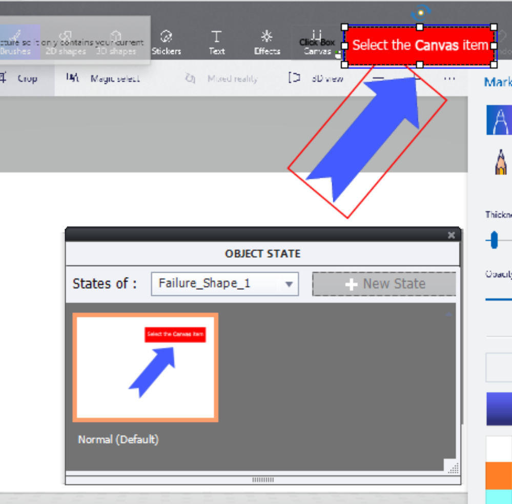

Do you allow multiple attempts? If you use a shape as Failure 'caption' you can add an arrow to the Failure message, just checked it out as you can see in this screenshot:
It is a Failure shape in a Software simulation, Assessment mode. Tested also with Preview HTML in Browser, the arrow will appear. That is the easiest solution.

Got it. For now, I just deleted the hint caption and applied a normal text caption with the hint text. One more question. How can I make an object, an arrow for example, appear with the Failure text? So, if the user mis-clicks, an arrow will appear with the failure text pointing the user where to click.

For your last question: is it the default Failure caption? In that case use an advanced action. If it is a custom failure message, add the arrow to the Normal state of the message.

Yes, it is the default faliure caption that was created when I recorded the software siomulation. It reads something like "Incorrect, please select the correct callout." I would like to add an arrow with the failure caption that points to the correct callout, should the user mis-click and the failure caption appear.
Got it. Where can I find the advanced action settings or how to I add the arrow to the failure caption? I am not seeing the options by right-clicking or under Properties.
Thanks!
New Here ,
Sep 22, 2021 Sep 22, 2021
That worked. You have been extremely helpful, thank you so much!
