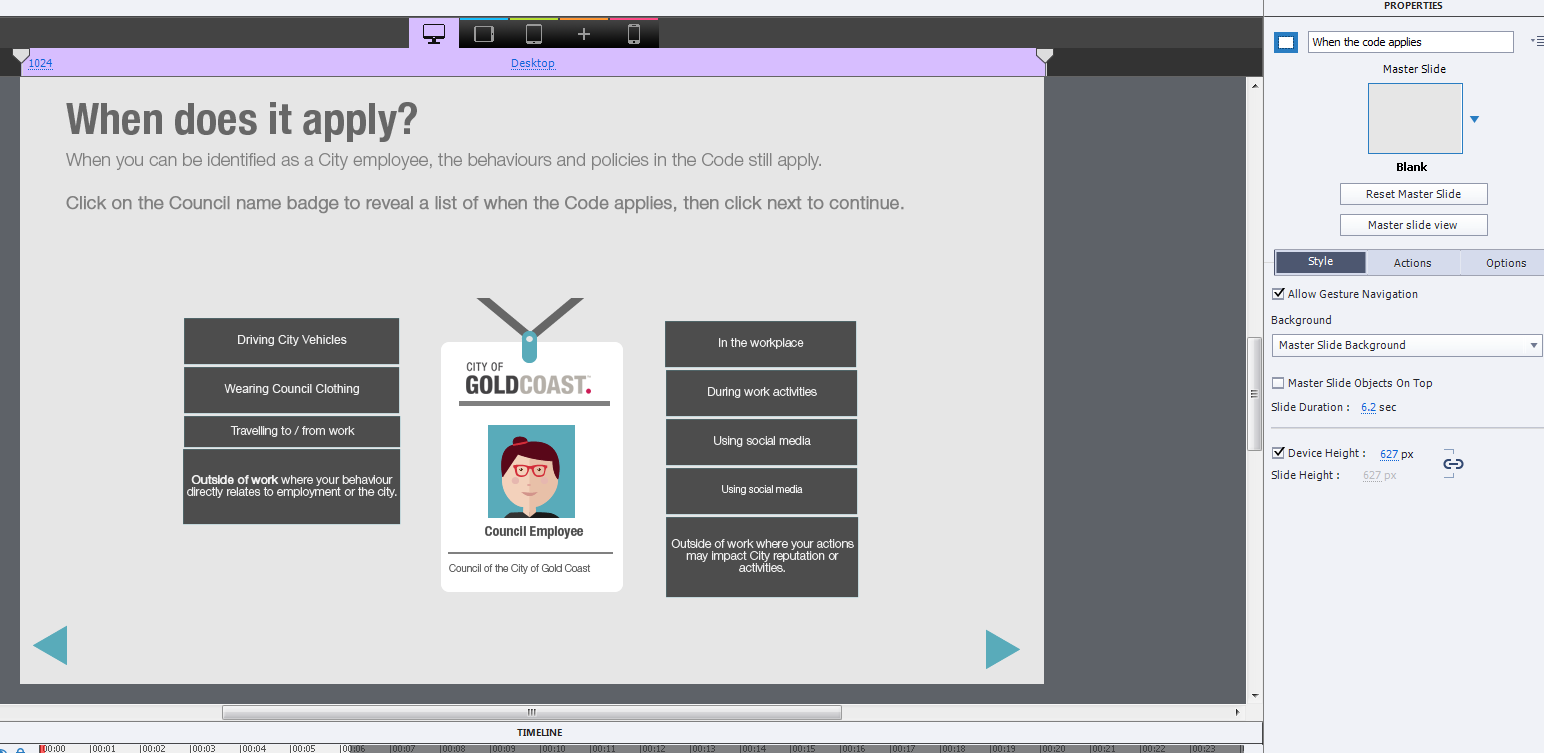

Aug 09, 2017 Aug 09, 2017
Hi Lily,
Is this helpful?
I just want the image that's on the desktop screen to remain the same size when I insert it in to the mobile screen.
Any help would be much appreciated
Aug 10, 2017 Aug 10, 2017
At this moment that object is set to a percentage of the width (17,8%) and the height to Auto, which means the ratio width/height will be kept, not distortion of the image.
If you want it to keep its size, please change both width and height to pixels, same numbers as in the desktop breakpoint. You will have to check the result because you probably will have to change the locations of the other objects to keep that space available.
Explorer ,
Aug 15, 2017 Aug 15, 2017
Thanks Lily, looks like the best way to go is to set the object width / height to pixels in the desktop view. This ensures that the object keeps it size as breakpoints change.
