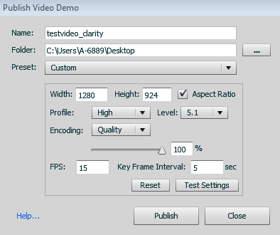

We had done a screen capture in adobe Captivate based on recommended settings, but found that there is a clarity issue. The video colour mode selected is 32 bit.
The system specifications are Windows 7 Professional, 64-bit operating system and the RAM is 8GB. The Graphics Card used is Standard VGA Graphics Adapter.
In the captured video, the logo on the right top corner appears pixelated.
The overall video clarity is affected.
How do we sort this out?
Any other specifications to be taken care while recording a video in captivate?
Thank You.

Attaching a screenshot to show how it appears.

So the published output is NOT scaled UP from the capture size, correct?
How about trying to scale it down?
If you output to, say, 800x600, does that improve the issue? If so, then just try working the resolution down between 800x600 and the captured resolution...
(note, if you set the width to 800 and keep 'Aspect Ratio' checked, which I'd recommend, the height will likely be less than 600...as 1280x924 is neither true 4:3 or 16:9... In fact, if you can't find a solution with the current capture, you may want to try recapturing and ensuring your capture area is true 4:3...i.e. 1280x960)

The first steps I suggest relate to the output panel he shows - just scale-down the image output.
The second steps have to do with the capture area...can you not specify the exact capture area when setting up a video demo project?
