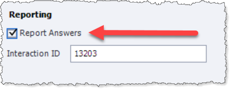

On the Quiz > Reporting screen, the Interaction Data option should be selected as shown below.
Also compare settings on all quiz question slides on the Quiz tab to make sure Report Answers is selected.
New Here ,
Jul 26, 2020 Jul 26, 2020
Yes both projects have Interaction Data and Report Answers selected.

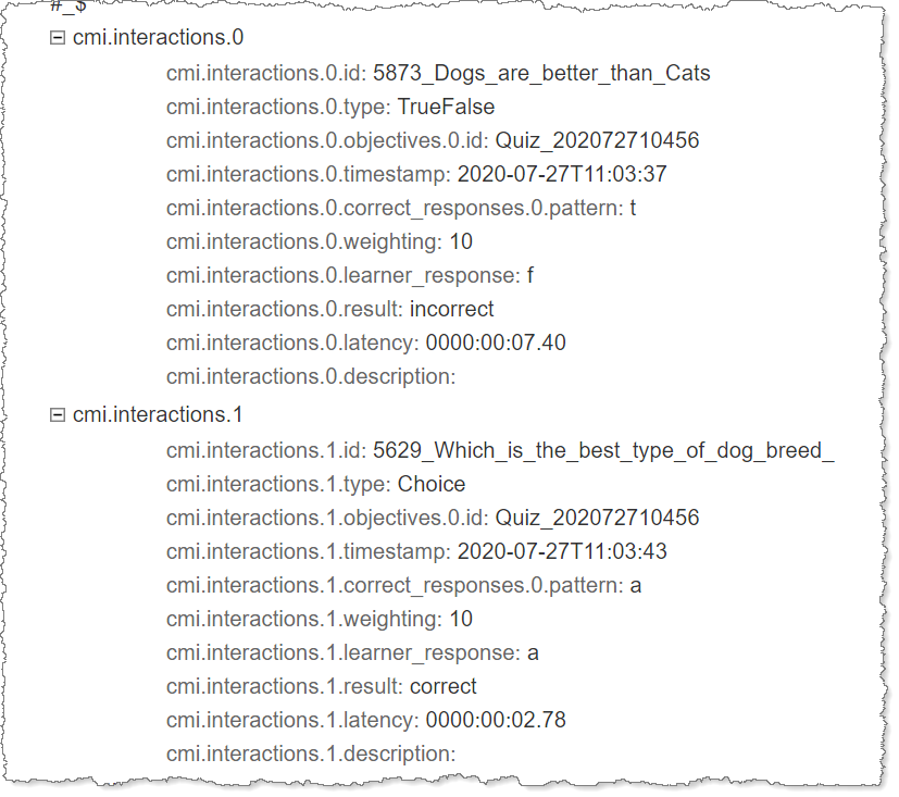

I just performed a quick test of a SCORM 1.2 project from Cp 2019 with two quiz questions uploaded to SCORM Cloud to see if the Interaction Data was recorded properly.  As you can see below, the details of each quiz question are definitely getting sent by the module.
It would appear to me that perhaps the issue is with your LMS, because data is definitely being sent but perhaps not captured.
