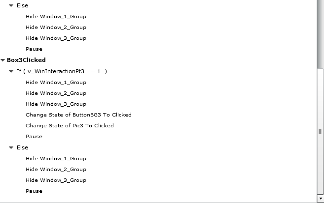

Here are the preview panels for the slide start:
here is the script for hitting the button:
Likes

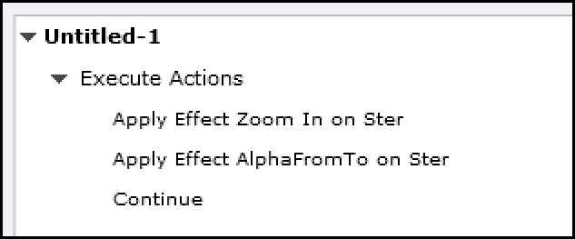

I tried to see the logic of your actions.
The action On Enter could be simplified a lot. I see that for the decisions 2-4 you are hidiing the three Windwo...group. Why not do it in the first decision, since it has to be done anyway. You can then get rid of all the ELSE parts, only the THEN (which is the part immediately after the IF condition) is relevant.
Moreover I don't see the reason of the Pause command: why do you want the slide to pause at the first frame? Moreover the Pause is missing for the second decision, why do you want to stop at the first frame only for the second and third Box?
The button action: you canot zoom in an object that is invisible, the group has been set invisible with the On Enter action. Moreover you keep the timeline paused, the effect cannot paly. I would like to see the timeline. Got it to work with thiese changes:
  • Instead of hiding the group I used the On Enter action to set the Alpha to 0.
  • I added an interactive object with a pausing point later than that of the buttons, you need just enough time for the Entrance, Zoom In duration.
  • For the button click you need now two effects (or one custom effect)  and you have to release the playhead I created this for one object (ster). THe AlphaFromTo has a very short duration (0,1sec) and sets the alpha back from 0 to 100%.
Alternative would be using a timed effect in combination with micronavigation.
I have a last question: it is still not clear to me how the variable is toggled from 0 to 1.
