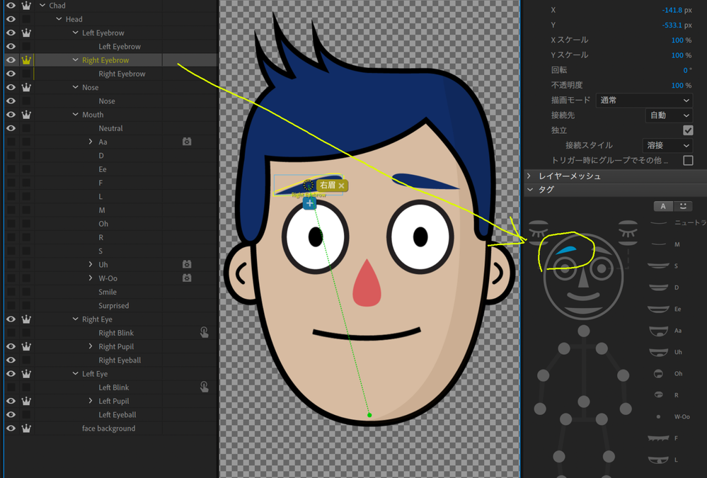

As far as the attached image is concerned
It appears that the right eyebrow is not tagged with the right brow.
Try selecting the right eyebrow from the doll icon on the right and add a tag.right eyebrow.png

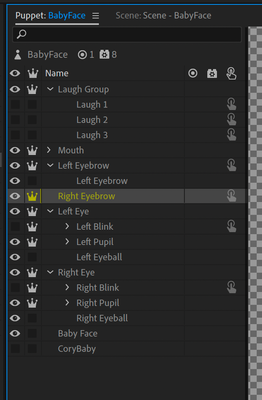

OK, I did that... But the eyebrows still disappear once I add a trigger and go into record mode.
The eyebrows work great, when linked to the camera, but disappear when I add a trigger.
Maybe I'm adding the trigger wrong, but my other triggers work for laughing and blinking...
Sep 17, 2024 Sep 17, 2024
In the trigger set that disappears.
Is the right eyebrow layer added?
If you share your puppet I can take a closer look.
