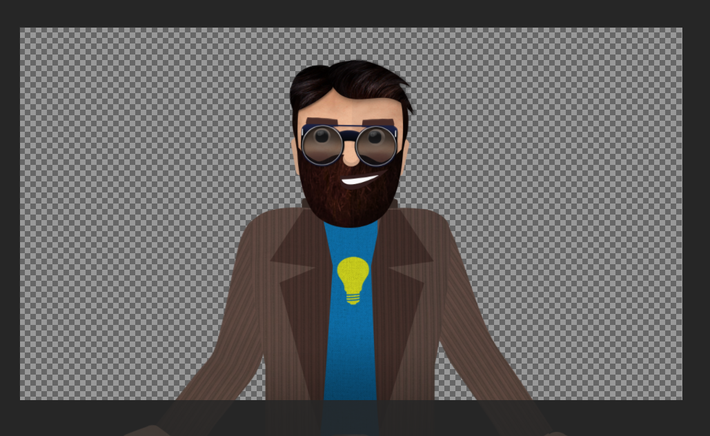

So a lot of your guys have the lower part of the head being distorted because when you turn the head. My guy has a beard and it looked weird. But I could not figure out how to get the head to act independant. Then I realized I didn't have to.
All I had to do was place the beard on top of the head. The head is still warping in the back but the beard covers that from the viewer. This can be done on other characters by using a seperate lower jaw in the same way. In the future I will design my characters with a neck and a ball on top. Then place the lower part of the head into the group so i will not morph. Might take some tweaking but I have seen many people complain about this in the forum and I think this will solve the problem of head warp for most characters.

A question on your beard however - "All I had to do was place the beard on top of the head". Could you expand on this? What was the exact hierarchy you used? Is the beard an independent group (to stop warping) but still under the Head group (so can be attached to move with the head group)? Could you expand? Thanks!
Community Beginner ,
Feb 20, 2018 Feb 20, 2018
I attached it in the same way I attached the glasses. just a layer on top of the head layer
