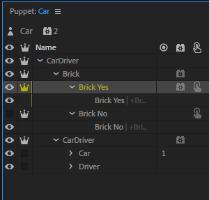

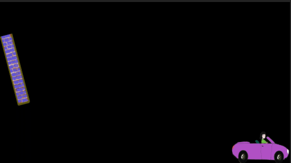

Another, maybe easier, approach might be to try putting the physics behavior at a lower hierarchy in the rigging. Here is a scene that has a similar requirement. The brick walls are the swap set. The blue wall has the collide and dynamic tags and the physics behavior. The red wall doesn't. The car and driver are in a separate group, with its own physics behavior.

So Jerry are you saying something like putting the "collision" tag within a nested independent group might restrict it better? Make the umbrella independent and tag that?
My low tech solution I used once - clone the puppet and set collide on the clone (not the original). Hey! I said it was low tech! 😉

This is my rigging for the car and wall scene.
