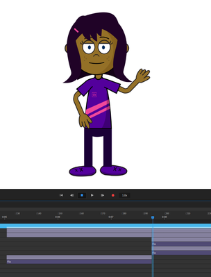

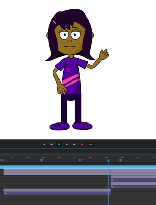

Yes, correct. I will try to explain it in another way...
I used Chloe puppet and recorded movement sequence Wave (W) - Hips (Q).
Just before (Q) her hand looks like this
Just after (Q) look like this
My intension is learn Chloe to swap her hand from default to flip after some time, not at the start of hips trigger. Lets say in the middle of the movement.
