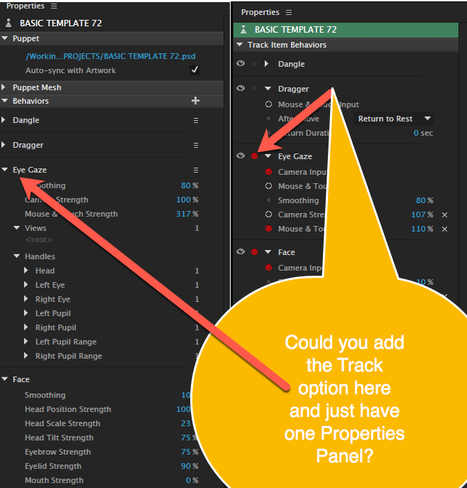

My first problem was getting to and from the different Behavior/Properties related Panels. There are two and I understand that there is one for use when recording, but they look very similar except for the Track option... Could you just have one Properties Panel with the Track option in it?
I then noted that there was only one place for Mouse & Touch Input, so I activated this, but nothing seemed t happen!?
To make my task a bit easier I decide to keep the head static by turning the Head Position Strength to 0. This worked fine, but then I noticed that when I view the other Properties Panel.. this was still set at 100%... so I've got no idea how this works and how the two Properties relate to each other!?

Adobe Employee ,
Nov 17, 2016 Nov 17, 2016
If I remember correctly there is a bug when you only have one eye.
The puppet panel properties are the defaults; the puppet-in-a-scene properties start as defaults but then you can further tweak them in that instance. So you could have multiple versions of the puppet in your scene with slightly different values if need be.

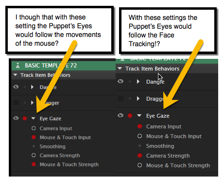

Engaged ,
Hello Richard,
just a small addition concerning the "test range" eye-gaze-arming that Dave suggested, that you said you couldn't get to work.
in order to do this, in the "eye gaze" props sub-panel, you want to disarm "camera" and arm "mouse input"…

Nov 18, 2016 Nov 18, 2016
Hi Wombat!
I take it you mean:
Engaged ,
Nov 19, 2016 Nov 19, 2016
Exactly! I don't know whether you knew that but in the screenshot you posted above the mouse input was disarmed… (As in the right screenshot you just posted…)

Engaged ,
Nov 21, 2016 Nov 21, 2016
Yes, that's correct!
Sorry if I've been confusing you. Let me try to clear this up a little. What I meant:
a) Dave suggested: "A test I like to do is arming Eye Gaze > Mouse & Touch Input and then dragging to see the full range."
b) In the next screenshot you posted you had Eye Gaze > Mouse & Touch Input disarmed.
c) I pointed this out.
Hope that helps… : )
