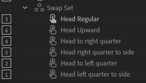

Ok so here's my swap set

LEGEND ,
Aug 22, 2020 Aug 22, 2020
As a suggested experiment, try removing the "Nose" tag from the layer. I *think* nose is mainly for parallax effects. So if you don't need that, just don't tag it as a nose (don't call the layer "nose" as well, to prevent auto-tagging).
Normally things get stuck when the wrong behavior grabs control of it. Some behaviors I think don't understand multiple instances of things, whereas others do. So it might be the correct behavior found a nose and stopped, so the other profiles have something else binding to the nose - something like that.
If you go through behaviors and look and Views and Handles etc, you might find one called "Nose" - I would look at those bindings to see if you can find something interesting (e.g. two behaviors binding to different noses, or a behavior binding to only one of the noses, etc).
