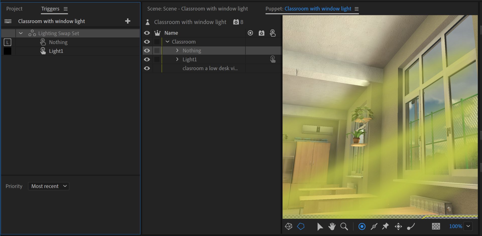

I forgot I was going to try and give this a go. Here is a plain trigger. Pressing "L" makes the light through the window appear. Note that "default" cannot be turned on, so you cannot make it "on by default". Even selecting latch you cannot make it on by default. (You can submit feature requests by the way!)
Here is a swapset added. I created another empty layer in the artwork, then added the light and "nothing" layers into a swapset. I then put the "L" for light on the "nothing" layer, and made the Light the default selection for the swapset. This then works - pressing "L" makes the light go away rather than appear.

If you would like some more help could you provide more information? E.g. Show the rigging structure, share a puppet, etc. The screenshots I included had it working, so it is possible. It must be something specific to your situation.
