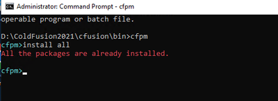

Hi @harshp_0559 , the object-instantiation error makes me wonder whether some packages, such as those required for Mail and Print, are missing. I would therefore suggest that you install all the packages. At least, to start with.
Assuming you are on Windows, you could do the following:
  1. Open the Command Prompt (cmd) as Administrator;
  2. Use the DOS cd command to navigate to  {CF2021_HOME_DIR}/cfusion/bin;
  3. Type cfpm and press ENTER. You should get ColdFusion's package manager prompt cfpm;
  4. Run the command install all
5.  Keep running the command install all till the result is either an irreversible error or ColdFusion tells you that "All the packages are already installed".
6. If the former, then share the error message with the forum. If the later, then restart ColdFusion in the usual way, and you're set to go.

@BKBK  Thank you for getting back.
I tried the same as you suggested and got all packages are installed.
As mentioned in https://community.adobe.com/t5/coldfusion-discussions/now-live-adobe-coldfusion-2023-and-2021-june-2... by Charlie i have also checked for the  Jetty/lib/ext but everything is already present in the folder as from the backup folder from the update and the backup i took of the CF folder prior to applying the update.

  8.  Now use the downloadrepo command to download the packages repository. To do so, type downloadrepo D:\ColdFusion2021\bundles and press ENTER. It may take up to half an hour for the download to complete. So be patient. The cfpm cursor will reappear when the download is complete.
  9.  Verify that the directory D:/ColdFusion2021/bundles indeed contains the downloaded packages.
  10.  Edit /lib/neo-updates.xml and make sure it contains the following:
<packagesurl>file:///D:/ColdFusion2021/bundles/bundlesdependency.json</packagesurl>
<defaultpackagesurl>file:///D:/ColdFusion2021/bundles/bundlesdependency.json</defaultpackagesurl>
11.  Restart ColdFusion 2021.
12.  Check whether ColdFusion 2021 now works as expected.
New Here ,
Dec 23, 2024 Dec 23, 2024
@BKBK Thank you for those steps. It worked and now all the sections are seeing hte packages installed.
But CF is still throwing the below warnings.  from looking at the log the Unable to determine dialect of the StAX implementation warning started after i applied the udpate.
