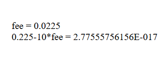

The problem is not caused by rounding, nor by numberFormat(). It is caused by the way in which ColdFusion stores floating-point numbers. This differs from the way in which other CFML engines (such as Lucee, Box Lang, Railo) store such numbers.
As Charlie has shown, ColdFusion uses Double type when storing or manipulating decimals like fee. But using Double type loses precision. Which is why other languages like Lucee and Box Lang "promote" decimals to BigDecimal, which retains precision.
So, the variable "fee", which ColdFusion treats as a Double, will, as a result, lose precision by the time it enters numberFormat() as an argument. You can see it for yourself by running the following code:
<cfset fee=0.0225>
The operation 0.225-10*fee triggers a conversion to double,
with loss of precision
<cfoutput>
fee = #fee#<br>
0.225-10*fee = #0.225-10*fee#<br>
</cfoutput>
The output:
This is indeed an old issue in ColdFusion, as Charlie has said. In fact it came up again recently in the CFML Slack. The discussion there contains interesting background information.
