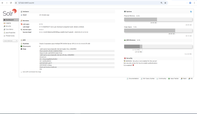

  4.  In the ColdFusion Administrator, navigate to the 'Solr Server' page and confirm the Solr port number (8997).
  5.  Open the URL http://127.0.0.1:8997/solr/ in a browser. The result is as expected:

2b) One is that I notice your screenshot of the solr dashboard, it shows one of the values as -Dsolr.solr.home=multicore. From my experience, that's the value one gets if you have implemented the separate add-on installer, in which case of course you need to be editing the jetty-ipaccess.xml within the etc subfolder where THAT was installed. By default, it would be /ColdFusion2025Add-onServices.
Sadly, that solr dashboard does not confirm for us what folder the Solr is running in, beyond that jvm arg. (FWIW, with respect to the Jetty implemented within a CF2025 folder, the value would instead show -Dsolr.solr.home=C:\ColdFusion2025\cfusion\jetty\multicore

  1.  After launching the URL http://127.0.0.1:8997/solr/#/ in a browser
  2.  After launching the URL http://[::1]:8997/solr/#/ in a browser
  3.  The logs:
         C:\ColdFusion2025Add-onServices\logs\2025_09_05.stderrout.log (Timezone: Central European Summer Time = GMT+2Hours)
    2025-09-05 10:48:13.995:INFO:oejsh.ContextHandler:main: Started o.e.j.w.WebAppContext@2f217633{solr,/solr,file:///C:/ColdFusion2025Add-onServices/work/jetty-0_0_0_0-0-solr_war-_solr-any-/webapp/,AVAILABLE}{C:\ColdFusion2025Add-onServices\webapps\solr.war}
    2025-09-05 10:48:14.060:INFO:oejsh.ContextHandler:main: Started o.e.j.w.WebAppContext@a530d0a{AdminServlet,/AdminServlet,file:///C:/ColdFusion2025Add-onServices/work/jetty-0_0_0_0-0-AdminServlet_war-_AdminServlet-any-/webapp/,AVAILABLE}{C:\ColdFusion2025Add-onServices\webapps\AdminServlet.war}
    2025-09-05 10:48:14.062:INFO:oejs.RequestLogWriter:main: Opened C:\ColdFusion2025Add-onServices\logs\2025_09_05.request.log
    2025-09-05 10:48:14.083:INFO:oejs.AbstractConnector:main: Started ServerConnector@ca2cd5e{HTTP/1.1, (http/1.1)}{0.0.0.0:63305}
    2025-09-05 10:48:14.093:INFO:oejs.AbstractConnector:main: Started ServerConnector@a120b9{HTTP/1.1, (http/1.1)}{127.0.0.1:8997}
    2025-09-05 10:48:14.105:INFO:oejs.AbstractConnector:main: Started ServerConnector@ac417a2{HTTP/1.1, (http/1.1)}{::1:8997}
    2025-09-05 10:48:14.106:INFO:oejs.Server:main: Started @7232ms
         C:\ColdFusion2025Add-onServices\logs\2025_09_05.request.log (Timezone: GMT)
    127.0.0.1 - - [05/sep/2025:09:04:27 +0000] "GET /solr/ HTTP/1.1" 200 17145 "-" "Mozilla/5.0 (Windows NT 10.0; Win64; x64) AppleWebKit/537.36 (KHTML, like Gecko) Chrome/139.0.0.0 Safari/537.36"
    127.0.0.1 - - [05/sep/2025:09:04:28 +0000] "GET /solr/admin/cores?_=1757063068406&indexInfo=false&wt=json HTTP/1.1" 200 484 "http://127.0.0.1:8997/solr/" "Mozilla/5.0 (Windows NT 10.0; Win64; x64) AppleWebKit/537.36 (KHTML, like Gecko) Chrome/139.0.0.0 Safari/537.36"
    127.0.0.1 - - [05/sep/2025:09:04:28 +0000] "GET /solr/admin/info/system?_=1757063068406&wt=json HTTP/1.1" 200 2380 "http://127.0.0.1:8997/solr/" "Mozilla/5.0 (Windows NT 10.0; Win64; x64) AppleWebKit/537.36 (KHTML, like Gecko) Chrome/139.0.0.0 Safari/537.36"
    127.0.0.1 - - [05/sep/2025:09:04:28 +0000] "GET /solr/admin/info/system?_=1757063068406&wt=json HTTP/1.1" 200 2381 "http://127.0.0.1:8997/solr/" "Mozilla/5.0 (Windows NT 10.0; Win64; x64) AppleWebKit/537.36 (KHTML, like Gecko) Chrome/139.0.0.0 Safari/537.36"
    [0:0:0:0:0:0:0:1] - - [05/sep/2025:09:04:44 +0000] "GET /solr/ HTTP/1.1" 200 17145 "-" "Mozilla/5.0 (Windows NT 10.0; Win64; x64) AppleWebKit/537.36 (KHTML, like Gecko) Chrome/139.0.0.0 Safari/537.36"
    [0:0:0:0:0:0:0:1] - - [05/sep/2025:09:04:44 +0000] "GET /solr/admin/cores?_=1757063084803&indexInfo=false&wt=json HTTP/1.1" 200 484 "http://[::1]:8997/solr/" "Mozilla/5.0 (Windows NT 10.0; Win64; x64) AppleWebKit/537.36 (KHTML, like Gecko) Chrome/139.0.0.0 Safari/537.36"
    [0:0:0:0:0:0:0:1] - - [05/sep/2025:09:04:44 +0000] "GET /solr/admin/info/system?_=1757063084804&wt=json HTTP/1.1" 200 2379 "http://[::1]:8997/solr/" "Mozilla/5.0 (Windows NT 10.0; Win64; x64) AppleWebKit/537.36 (KHTML, like Gecko) Chrome/139.0.0.0 Safari/537.36"

Charlie, it's not just about my logs. It's about a whole demonstration of the whitelisting solution I proposed:
  • Jetty restarting without any issues;
  • URL access to Solr via 127.0.0.1;
  • URL access to Solr via ::1;
  • request.log showing the Solr requests were successful;
  • stderrout.log showing there were no errors.
