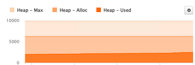

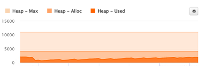

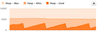

For diagnostic , I have fusion reactor installed. all i can tell from that is unusual heap mem usage when its slow
each dip occurs after I click a page and then makes this saw tooth patern untill the page is loaded. however when the server is working fine i get a simple straight line for heap usage
slightly different when i change the GC to G1 and the server is still slow

  3.  The inclines in the saw-tooth pattern suggest rising memory usage. ColdFusion would then be creating objects in memory, for example. The dips in the pattern suggest garbage collection.
    So, the saw-tooth could represent a period when your application repeatedly creates objects in memory, which are then garbage-collected. Think, for example, of a function that dynamically populates structs. The more the structs and the larger they are, the higher the memory usage. Suppose such a struct is var-scoped. Then the object representing it will be garbage-collected when the function returns.
    A similar pattern may also result from establishing database connections, running queries and then disposing of the objects afterwards.
    So, the saw-tooth is part and parcel of the workings. You shouldn't worry about it when it is well below maximum memory, as in your case.
  4.  However, as you alsready guessed, the saw-tooth may also be the result of a page being compiled. Compilation uses objects which are subsequently garbage-collected. Assuming that compilation is the issue, then caching might help.

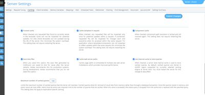

    To test this idea, switch caching on in the ColdFusion Administrator:
Explorer ,
Jun 28, 2022 Jun 28, 2022
Hi @BKBK , Thanks for the input. all cache settings are properly set. I am not that concerned about the saw tooth in FR as it was just something i noticed. not indicative of anythin i think. The real problem is the nature of the problem thats making it harder to pinpoint. if it were always presenting it would be easier to track. that fact that sometimes randomly it behaves fine is whats confusing
