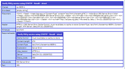

Trying to install and connect to the PDFg Service.  Windows Server.  Installation of Add-On Services goes just fine and it starts up the Windows Service just fine.  In CF Admin, under the PDF Service page, I try to "Verify" the connection and it fails saying "Connection verification failed for PDF Service Manager.  Looking at the logs in the Coldfusion Add-On Services folder, the stderrout.log shows the service successfully starting up on port 8993.  However the next several lines show the error from when I try to verify the service.  I can't find any similar issues like this so turning to the community for help.
Note: neo-document.xml has the same port (8993) that the service is running on.
Any other ideas out there?  Log entries are below:

Logs Upon Verifying from CF Admin
2022-01-31 22:10:25.233:WARN:oejshC.PDFgServlet:qtp1794717576-24: unavailable

What happens when you launch the following test code as a CFM page?
<cftry>
	<cfhttp url="http://127.0.0.1:8993/PDFgServlet/verify" method="get" result="httpResult"></cfhttp>
	<cfdump var="#httpResult#" label="Verify PDFg service using CFHTTP - Result">
<cfcatch type="any" >
	<cfdump var="#cfcatch#" label="Verify PDFg service using CFHTTP - Error">
</cfcatch>
</cftry>
If you continue to get java.util.ConcurrentModificationException with the above test, it will mean race conditions. That is, two or more threads are simultaneously trying to get access to the same servlet. That will in turn suggest that two instances of the PDFg service are running.

When I run the code you provide, I just get a generic 500 Server error as follows.
