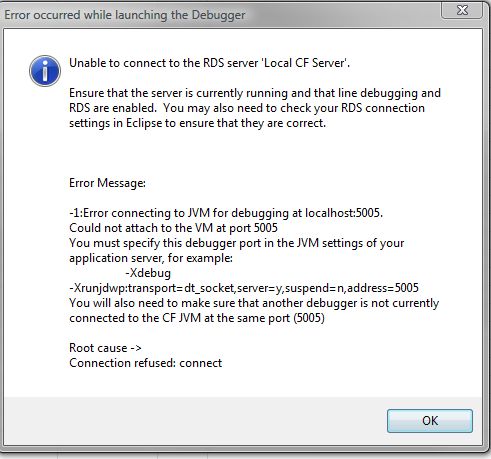

I can't get my Debugger to work.  I'm using a locol development CF and a remote MYSql Database. RDS is enabled and I have check to see the the port 5005 is not conflicting.  When I launch the debugger I get an error. Any help greatly appreciated.  Been messing with this for hours.
Settings and errors below.

First, I'm afraid there are just too many things that could be amiss, whether in your setup of the Debug configuration, the project, the CFB-to-server definition, the CF server configuration, your firewall, and so on. It would be difficult to list all the things you may want to check, that perhaps either you have not configured, or not configured properly.

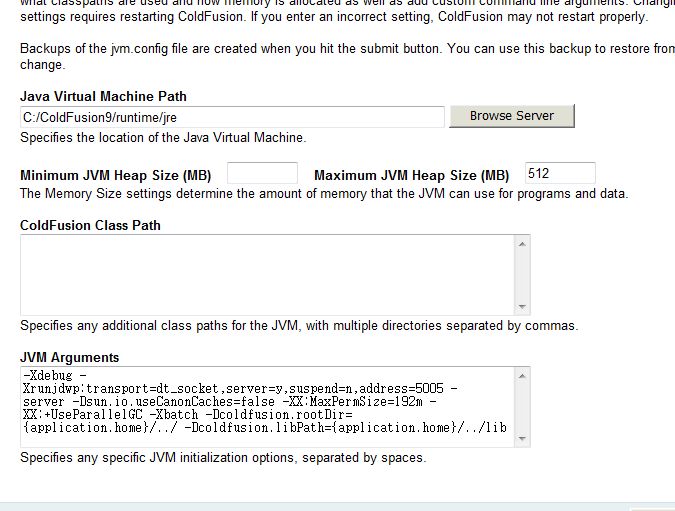

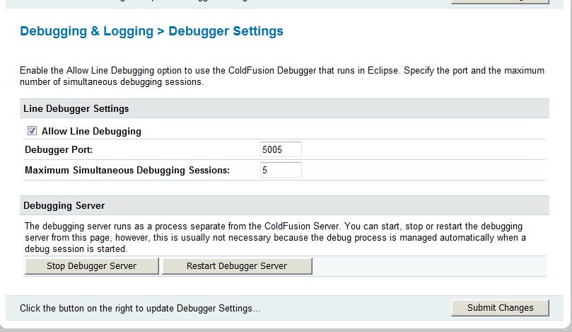

Go to Debugger Setting in Administrator and enable "Allow Line Debugging " and Debugger port which you have defined in JVM Config.
Now Click on Start Debugger Server.
Hope it will help...
