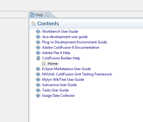

And no the CFB Help is not in the Eclispe help at all, never has and it was removed from the IDE about 3 RC's before final release and was never put back in. Like I said I don't want to go to an external application, nor do I want to swap windows it needs to be in the IDE.
I know the help program you are talking about, and it is a box of shit. Pardon the term there, but I don't want to run something that is as slow as heel, nor do I want anything that is external to my IDE. The point of inline help is that I am not switching applications/windows all the time, I can look read and code at the same time. That is called productivity and something that I know for a fact that Adobe doesn't care about, because if they did they would have read my ticket on this and understood the need of it in the first place.
As shown, I usually have this docked off to the side so that I can just click the icon and expand the view. Adobe never/or refused to think about people wanting to use it this way, I raised it as a bug that they claimed they fixed. Yeah right, and since ColdFusion 9.01 was released the ColdFusion one listed in the image has NEVER been updated either.

The CFBuilder help does "actually have help information...within this application when it comes to itself".
I don't know what's happening for you, but there should be a "ColdFusion Builder Help" item in the CFBuilder Help menu. Do you not see one? If not, that would seem to be a bug. If it's there and you missed it, I hope it serves your desire to stay within the app. That's certainly its intention. (I only point to URLs because they're easier than telling people what section to find within the online help inside CFB.)
And that CFBuilder help is in fact the full "Using Adobe ColdFusionBuilder" document I've been referring to, and also the "Installing ColdFusionBuilder" document, which we should all read for sure.
I hope I'm helping with your challenges. I certainly don't mean to be hitting you when you're down, but instead I'm trying to help you up.
