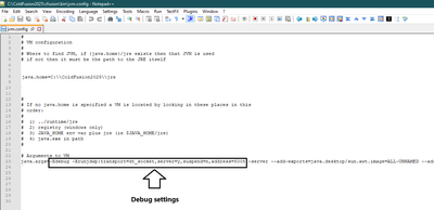

    @lerxst3 , JDWP stands for Java Debug Wire Protocol. This is the protocol used for communication between the debugger of a Java application, such as ColdFusion, and the Java Virtual Machine. This communication requires a dedicated port. In ColdFusion the JVM settings to enable debugging are located in /cfusion/bin/jvm.config, and look like this:
    As you can see, the debug port in this case is 5005. Find out what your own debug port is.

      Killing a task might lead to other issues. An alternative, perhaps simpler, way to avoid the port conflict is to change ColdFusion's JDWP port.
      Again using my case for example, the steps would be:
      1.  In jvm.config, change the port("address") value from 5005 to, say, 5007. (Of course, after having confirmed that the port 5007 is free.)
      # Arguments to VM
      java.args=-Xdebug -Xrunjdwp:transport=dt_socket,server=y,suspend=n,address=5007 -server ...etc
      2.  Restart ColdFusion.
