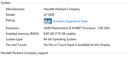

Is Win7 64 bit? Was 64 bit or 32 bit copy of CF9 installed?
Can you tick - configure web server box?
Once ticked does OK button enable?

I have Windows 7 64 bit computer and I downloaded ColdFusion_9_WWE_win64 which I beleive it is 64 bits.
The OK button does not enabled when I tick configure web server box.
Here is my computer system property.
iccsi

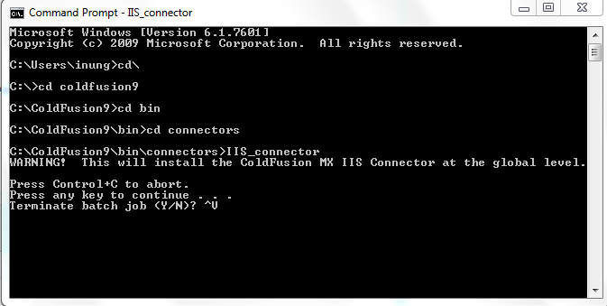

Try run the CF IIS configuration from DOS CMD prompt.
>CD ColdFusion9\bin\connectors
>IIS_connector.bat
Any errors prompts messages in the DOS window?
Perhaps you installed CF9 to use built in web server - open Adobe program group > properties of Administrator tries to HTTP to another port than 80 eg 8501. Run that URL? Tho even if installed built on web server should still be able to map IIS.
here is the message,
Is it possible ISP block the IIS enabled?
Can you please adivse how to change the port?
