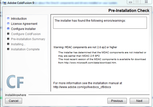

I running x64 Windows 7 Enterprise Edition on my local machine. I'm trying to install ColdFusion x64 developer edition on my local machine but keep getting an MDAC error. (See Attached Image)
I tried to install MDAC Components from microsft but it still doesn't fix the problem. (http://www.microsoft.com/download/en/details.aspx?id=5793) The install is only x86, but I installed it anyways hoping it might work. It did not solve the problem so I figured I would try installing the x86 version of ColdFusion. I ran into the same exact error upon install.
I also ran the MDAC Component Checker and it returned an "UNKNOWN" result.
I've never had this problem even with my x64 Windows 7 at home. I'm not sure if this has anything to do with my work computer's admin restrictions. My privledges are limited.

OK, I just spun up an instance of Win7 Enterprise and tried installing. Unsurprisingly, I do NOT get the error when I try to install as Administrator, but I DO receive it when I try to install as a restricted user.
So I guess that is your answer. It does not surprise me that installing ColdFusion as a restricted user would have problems.

*SOLVED*
I ended up having to "right click" the installer and "Run as Administrator" and enter a admin username/password. After doing so, I did not receive a MDAC error from the CF installer pre-check.
I also upgraded SQL Server Manager from 2005 to 2008 prior to trying the "Run as Admin". I'm not sure if this had any influence on helping the installer suceed, but my registry said that the MDAC components did not change. So, I think the MDAC error was actually being produced due to me not being a system admin.
