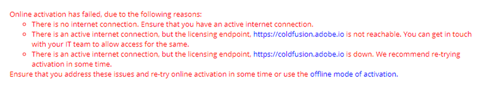

We reinstalled Coldfusion 2021 and attempted to activate our license again and got this error:
We tried following the offline activation method, but got the following error when uploading the license file.Screen Shot 2022-12-15 at 8.37.38 AM.png
After applying the latest patches, we tried accessing the activation page again, and it was extremely slow in loading.  This is what we saw in the network logs of our browser.
Eventually the page loaded, but we tried activating the license again, and continued to get the first error message.
