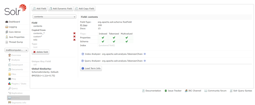

Despite its absence in search results on prod it does exist in teh schema but what I'm seeing is that the contents column on prod is not indexed, tokenized or stored whereas on dev it is. (reading the fourm post linked above will clarify this).
The next image is the config for "contents" on my dev machine.
And the next one is the config for "contents" on prod. Note teh difference in teh state of "Index".
