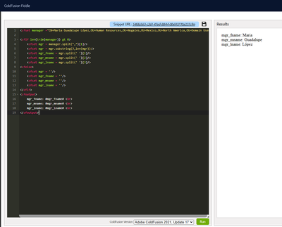

Taking the hint from you, I ran the following code on CF2021 Update 17 on Cffiddle:
<cfset manager ="CN=Maria Guadalupe López,OU=Human Resources,OU=Nogales,OU=Mexico,OU=North America,OU=Domain Users,OU=Offices,DC=humanscale,DC=com">
<cfif len(trim(manager)) gt 0>
	<cfset mgr = manager.split(",")[1]/>
	<cfset mgr = mgr.substring(3,len(mgr))/>
	<cfset mgr_fname = mgr.split(' ')[1]/>
	<cfset mgr_mname = mgr.split(' ')[2]/>
	<cfset mgr_lname = mgr.split(' ')[3]/>
<cfelse>
	<cfset mgr = ''/>
	<cfset mgr_fname = ''/>
	<cfset mgr_mname = ''/>
	<cfset mgr_lname = ''/>
</cfif>
<cfoutput>
	mgr_fname: #mgr_fname# <br>
	mgr_mname: #mgr_mname# <br>
	mgr_lname: #mgr_lname# <br>
</cfoutput>
https://cffiddle.org/app/file?filepath=9cf84e08-8565-43b6-b710-d8a0472bb9ac/73ad24d8-be36-4aa6-8586-...
As you can see, it works as expected.
If you're still having an issue with this, then you will probably have to look elsewhere. For example, shouldn't the line

I appreciate you may be happy to have found "any solution", but l would lament if future readers saw those two currently marked answers about tostring if that proved ultimately to be an unnecessary workaround. Sadly most won't read the rest to hear if this might be the alternative root cause solution.
/Charlie (troubleshooter, carehart. org)
Nov 06, 2024 Nov 06, 2024
Charlie, the root cause of the problem is clear. As I mentioned earlier, "the issue is caused by the variable manager calling the split method.". The variable is of type coldfusion.sql.QueryColomn, for which there is no split method.
My focus is on how some of his cfldap query results would work but not others, as well as the asserted change being due to the recent cf update.
I don't see how your conclusion closes those considerations.
quote
By @Charlie Arehart
The error is "The split method was not found". I just wanted to clear any questions about the root cause of the error.
You have not succeeded in that desire, otherwise I wouldn't be asking. Anyway, my question was for Patrick. If he opts not to reply, then I leave what I said for the sake of others.
I'll leave it there.
