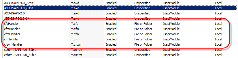

Make sure the web connector properly installed the wildcard mappings.  In IIS Manager, click on the server (not any of the sites), and then open the Handler Mappings feature.  You should have some entries like this:

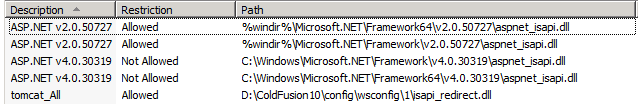

In IIS Manager, click on the server (not any of the sites), and then open the ISAPI and CGI Restrictions feature.  You should have some entries like this:
Check if you have the last one.
Guest
Sep 17, 2012 Sep 17, 2012
It is there...

I said that I installed CF 10 2x. The first time I installed it directly to D, then I uninstalled it, and reinstalled it in D:\Coldfusion10. After my second install the applicationHost.config file erroneously had all IsapiModule settings pointing to the location of my first install.
This is contrary to what IIS Manager was showing us in the screenshots... D:\CFusion10\config\wsconfig\1\isapi_redirect.dll - which is correct.
