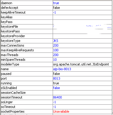

As promised, here are some screen grabs from a good period of activity...
The worker.properties and server.xml files for the instance are unchanged from the default install (max_reuse_connections=250 only).
My interpretation of this is that thread count reached a maximum of around 50 which is well within the maximum allowed of 200.
The result I can't explain is that the thread busy count seems to be dropping as soon as the thread is no longer in use. The Tomcat Connector docs (http://tomcat.apache.org/connectors-doc/reference/workers.html) state that the default value is indefinite (zero). I've not added a value for connection_pool_timeout so I'm guess the Adobe mod_jk is adding the -1 for keepAliveTimeout which I'm also guessing mean "drop as soon as unused"?
I hope this helps inform someone who might be able to make some sense out of all this! 🙂
Richard

See how your currentThreadCount drops to 10. With that much load I expect you could do better by having a greater value for connection_pool_minsize in workers.properties and minSpareThreads in server.xml which when not specified is 10 by default.
Interesting observation on keepAliveTimeout, as you say drops the thread straight away. Not sure how -1 gets in there since as you point out tomcat documents say otherwise. Perhaps something special about the Adobe CF modified tomcat.
Specifying a value for connection_pool_minsize, minSpareThreads and connection_pool_timeout, connectionTimeout could be a good idea tho you say the application usage has been fine over this period. Rather than making a change yet perhaps it would be better to know what those values or charts look like when the system is performing badly.

Your observations and suggestions on connection_pool_minsize, minSpareThreads and connection_pool_timeout, connectionTimeout raises a question I've had in my mind for some time.
Why release the threads at all? Why not wack them up high and forget about it?
My justification for this thought is that, assumably, when a request has finished with the thread it's marked as unused and can be adopted by a new request that needs a thread. Why drop it as, in time, if it's going to be opened again by the process when it has run out of free threads. Or have I misunderstood the technology?
Your thoughts on that would be appreciated.

The way I see it, no point to release thread only to have to make a new thread again since tomcat can use a thread that has been marked unused. Make enough threads to begin with to cope with the load.
Your thread graph shows 50 maximum used. I do not see any reason not to set minimum setting to 50 so all the threads are present ready to take work.

I know the peak topped out at 50 the other day but why stop there?
Why not 100, why not 150, why not match the connection_pool_size value? What are the consequences of a large number? These are the questions I'm struggling to find documented answers to.
