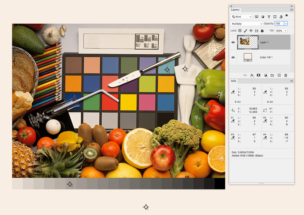

4. I'd not use "multiply" for the layer that Rob Day suggests (though it is the obvious approach), I'd use "Darken" mode. Just give it a try and decide yourself.

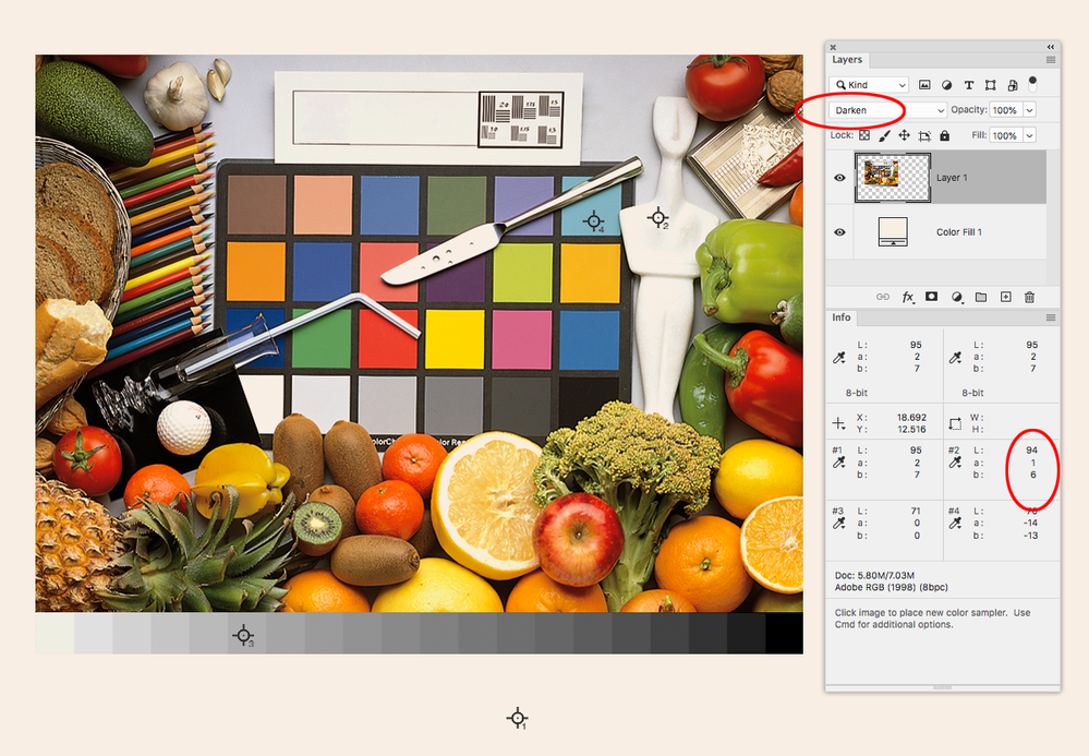

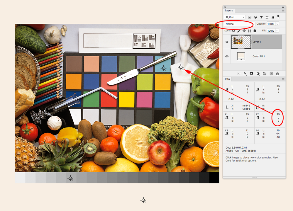

I think InDesign is Multiplying for the Overprint Preview because Darken would only affect image colors that are lighter than the [Paper]’s Lab value, so unless the sheet is darker in value than the image highlights there would be no proof effect.
Here the only affect Darken has is on the nearly white highlight at #2, the other samples don’t change.

Multiply has a some affect on all of the color—if the paper is creamy enough it might affect a color like 20% Cyan, which Darken would not show:
If the paper color gets darker than the image highlights, Darken mode just obscures the highlight detail without affecting the rest of the image.
