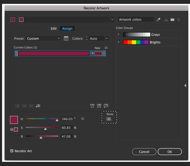

Your explanation sounds fairly easy to follow. However, I am fairly untrained in Illustrator and am missing some options that you mention. Specifically, I do not see Color Books and I can't find a way to view Pantone colors. Is there some sort of add-on I have to upload, or an integration to facilitate? I'm entirely new to the world of color and printing. Thanks in advance!Screen Shot 2018-10-23 at 12.01.28 PM.png

Hey Matt,
You'll find the color books option once you click on the tine box below None. Choose Pantone Solid Coated and then hit OK.
Explorer ,
Nov 07, 2018 Nov 07, 2018
Thank you!
