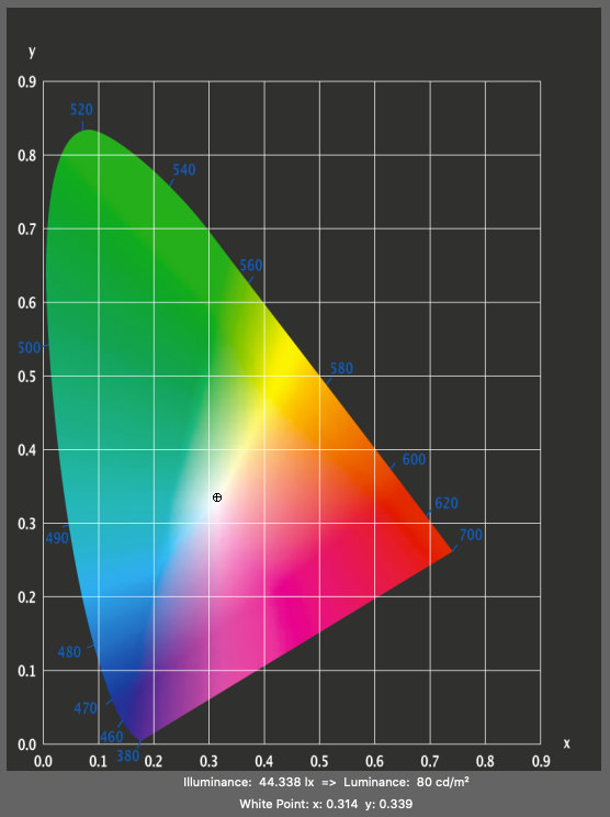

Hey Bob, as I said, I can not have a full control on the light where I'm working normally. I measured a few scenario:
Guide ,
Apr 07, 2020 Apr 07, 2020
So at 4400 k the room is more orange than is proper for good color management.  That explains why you are outside the normal range.  Just understand that is the main limitation now
