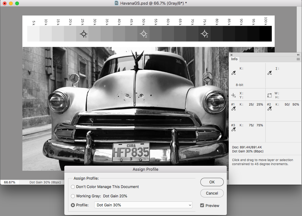

Yes, the K values listed in the Info panel are the values output to the press plate and not the printed sheet after the gain has occurred. If you place a grayscale in an InDesign document and export to PDF/X-1a with document CMYK as the destination, the values you read in AcrobatPro’s Output Preview would be unchanged from Photoshop. The soft proof (the conversion from the gray profile to your monitor’s profile for display) shows the expected affect of dot gain. You can see that via Edit>Assign Profile... and choosing 10% Dot Gain vs. 30% Dot Gain—the output numbers don’t change but the preview does:
A curve based profile like 25% Dot Gain is somewhat problematic in that it is simply a midtone adjustment, and when you print on a paper like newsprint the shadows appear lighter and the highlights appear darker (less contrast), and a Black Ink newsprint profile would soft proof that affect assuming you have an accurate monitor profile.

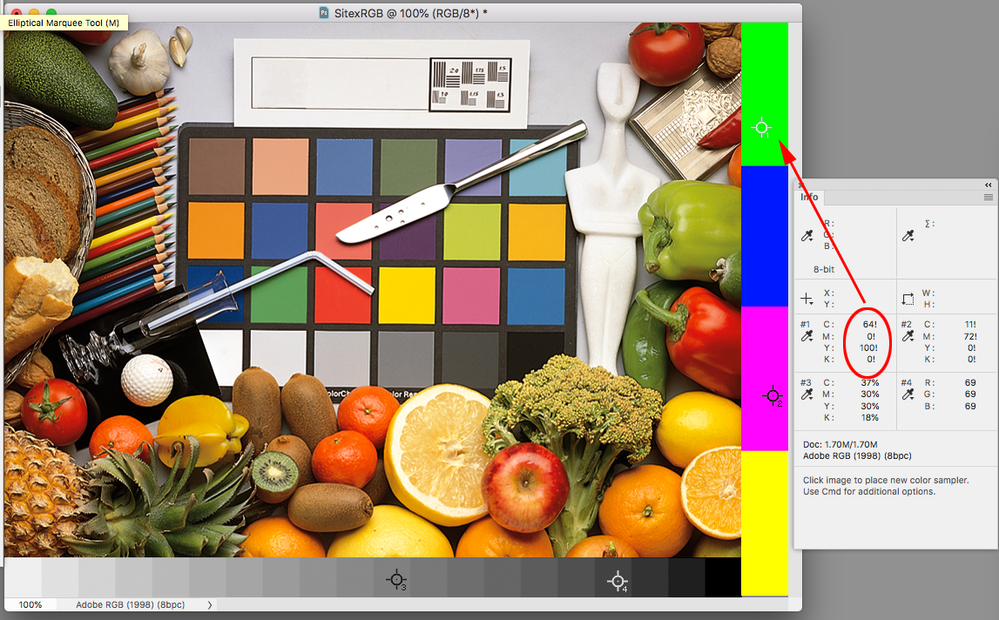

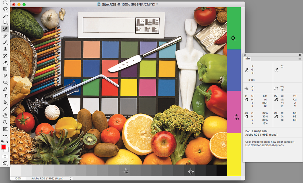

In Photoshop you don’t have to actually make the conversion to CMYK in order to soft proof how the color will convert to the destination CMYK profile, or if you prefer, color correct by the output numbers.
If you set your Color Settings Working CMYK space to the destination profile, set your Proofing Setup to Working CMYK, and turn on Proof Colors, the soft proof will show the conversion while you work in your RGB editing space. The same will happen in InDesign if you turn on Overprint Preview.
Here I have an RGB image with some patches that are clearly out-of-gamut. With Proof Colors turned off I see the RGB gamut—the Info panel set to CMYK (or Proof Color) shows the CMYK output numbers for the Working CMYK profile. If the color is out-of-gamut to the proofing space there will be an ! with the output numbers. The Color Settings’ Conversion Options also affect the output numbers.
Proof Colors off:
Proof Colors on:
