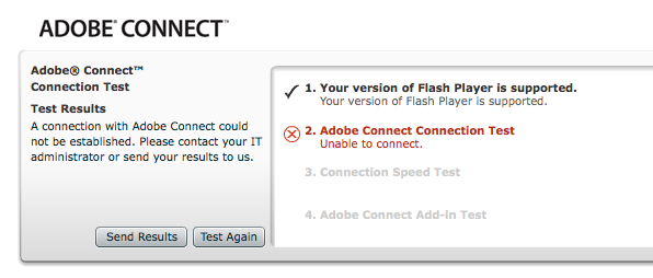

In the Adobe Connect Connection Test, I am getting a fail on step 2:  Adobe Connect connection test: unable to connect.
What is actually tested in this step?  I have 2 macbooks on the same network, 1 can get in and is hosting a meeting, the other can not.  Is there an error log to be looking at that might shed light on the issue?

This means that there is no communication between your computer and the Connect server.
If you want to see the details of what happened, click on Send Results and then the Details... link.
There is likely a firewall setting, or something similar, that is preventing the one computer for communicating with the Connect server.
