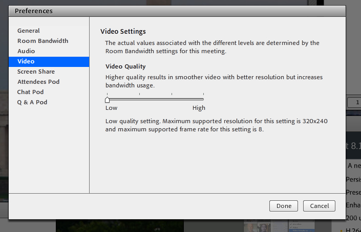

Now that being said. The host of a meeting controls the actual video bandwidth of the meeting. In your case the host should be using the lowest setting which would be fine for the size video you have there:

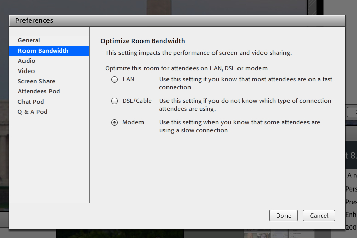

The other setting that affects you is this one:
That lowest setting is what many on the US Military use and they are very happen with performance. Adobe Connect then throttles (well..FMG does that underneath Connect) the load of data so there is no stuttering like you report. The reason you are getting stuttering is because the room is sending you too much data at too high a rate for your connection and because of your high latency delay then there is a mis-match of the data not being able to stream smoothly as you would expect.
